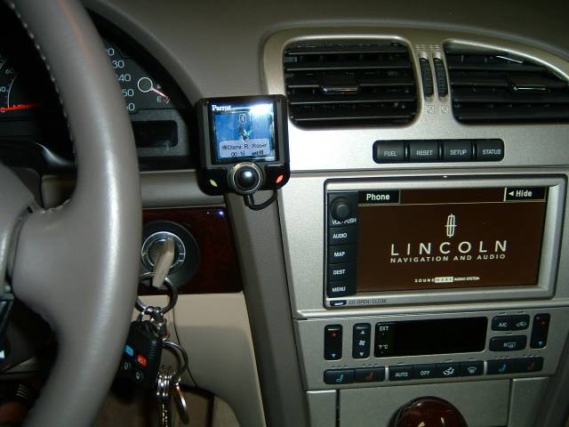

That's funny. I picked the color one because it seemed smaller. (It is a little taller, but it is not as wide as the mono.) Anyway, I just got it put in. Picture attached. I haven't tried it on the road yet, but so far it sounds good. It does have at least one bad feature. It mutes the radio several times just after power up as it is connecting to the phone.
Looks good joegr. I see you have a phone icon on the screen now.
What did the install cost you ?
Did they attach the desplay with double sided tape ?
Please post your impression here after you have it out on the road.

I installed it, so the install cost was about 90 minutes + the $189 or so for the Parrot (/w shipping).
The head unit is attached using the supplied Velcro.
I previously had a Nokia kit in, so I already had a harness that I could modify to fit. If you don't already have one, I think they are about $60, and you can get one that fits directly to the Parrot.
You have to install the Parrot microphone. I installed it to the track that runs down to the mirror. It is easy to route the cable behind the weatherstripping and the headliner.
Very clean installation. Great job!
What are the little icons on the Nav display ("Phone" and "Hide")?
Hide removes both the phone and the hide buttons. Phone does nothing.
It looks good but why did they make the screen so big? What all shows up on the screen? Thanks
The main use for the screen is that it displays your dialing directory from your phone. It really couldn't be any smaller and do that well. It can also display a (stored) picture of who's calling, but that's not of much interest to me.

Nice. I just have one question: why are you using the Valet key? :D
