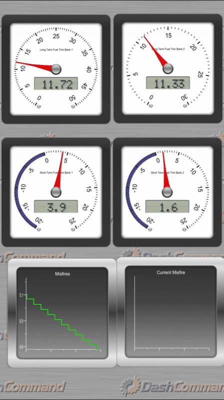

Thanks again to Joe for pointing me, and countless others, to misfires. I finally figured out how to check for misfires using my iPhone app diagnostic tools. And before I get yelled at: 04 V8 with all the bells and whistles, 217k miles. All plastics changed out and new coils in mid 2016. Been getting P0171 and P0174 and occasional P2195 and P2197 codes.
It appears that for the first 15-20 mins of the car running I get 1) high positive short term fuel trims and high (and erratic) long term fuel trims and 2) appear to have some misfires that look like they go away after complete warm up. Graph shows 6 misfires that were steadily going down. (see picture)
Also, the fuel trims are higher during idle and come down at higher RPM. So...

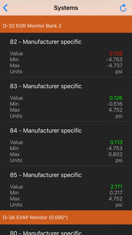

One other issue that is also still unresolved is that O-32 EGR Monitor Bank 2, 82-Manufacturer specific. I have a positive 0.077 reading and it says it should be between -4.753 and -4.737. I have not checked for a leak in the EGR hose fitting at the exhaust manifold. Maybe there is a leak there that "self seals" when hot????
...One other issue that is also still unresolved is that O-32 EGR Monitor Bank 2, 82-Manufacturer specific. I have a positive 0.077 reading and it says it should be between -4.753 and -4.737. I have not checked for a leak in the EGR hose fitting at the exhaust manifold. Maybe there is a leak there that "self seals" when hot????
There is one parameter that is always red flagged as out of bounds on both of my LSes, and this has been the case since both were new. I assume it is something the test software doesn't know about the LS, rather than an actual problem. I'll try to remember to check this weekend to see if it is indeed that EGR value.
Thanks, here is a picture of what one of my OBD2 apps tells me. I am gonna crawl underneath and see if the EGR/exhaust connection is loose.

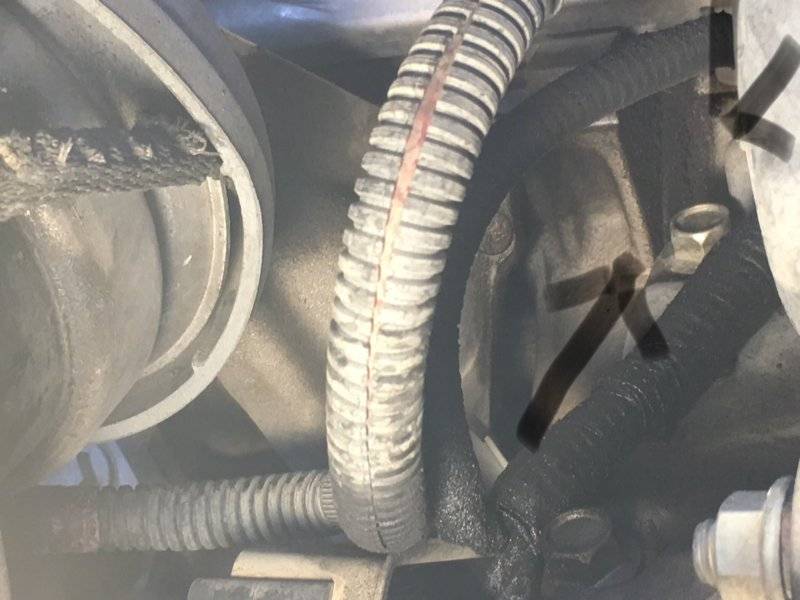

Crawled underneath and discovered there really isn’t a efficient way to check if the EGR hose/tube is secure. But, I did take this picture from the just past the alternator. There appears to be some soot right where the exhaust manifold attaches (between those lame arrows). Might this be a strong indication of an exhaust leak?
Is that soot, or is that accumulated oil grime (such as is on the wiring harness right there)?
