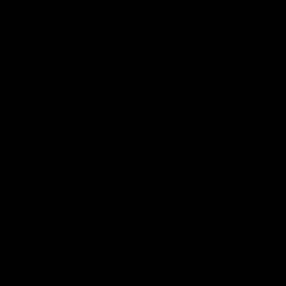

NGK Platinum plugs are basically OEM. $3 each at autozone and buy a gapper like this and gap them to spec.

That would be true were you to use a traditional "coin" gapper. The one I linked is suited for precious metal tipped plugs because if you use it correctly it will never contact the tip.
