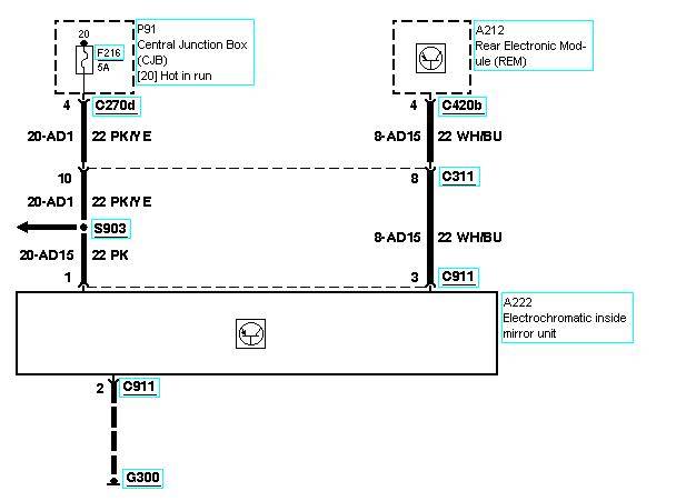

Great information. Can anyone tell me if the 00 v6 LS has the wiring for the auto dimming mirror in the front dome light/sunroof swiitch? I think I might of had one cause of a line on the windshield right there that won't come off. I have bought a auto-dimming mirror, but havn't hooked it up yet cause of not knowing the wiring.
here's a wiring schematic for the rear view mirror
Mirror wiring...
NickLS, thanks for the info, but man that looks like something I couldn't do. I'd need an electricial to translate that information. Could you like put , red wire hooks up to... black wire to.... other wires to.....
