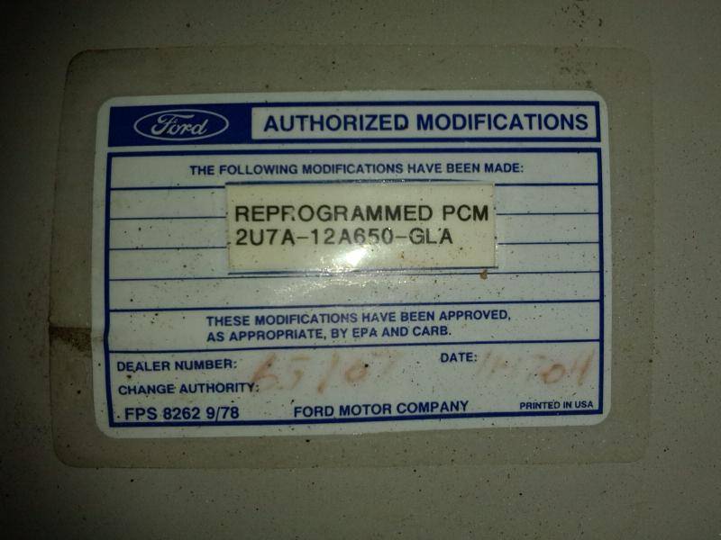

My new suspicion is the program for the manual transmission has some weakness. I noticed my EEC has been reprogrammed to watchcode TMT0 (tag on the fender).

3. Has your EEC been revised to TMT0 (2U7A-12A650- GLA)?
