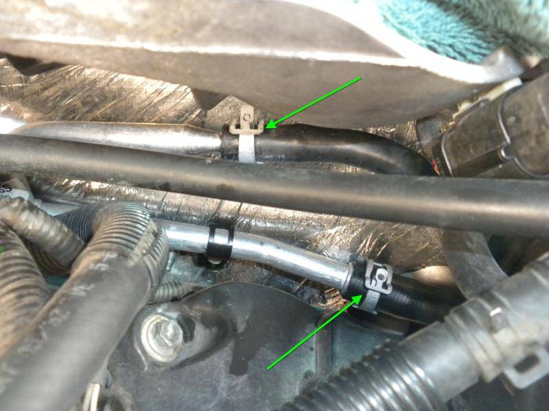

There are 2 hoses that connect to the degas bottle. You connected both hoses to both places on the firewall? Is the tank really Motorcraft and not a Dorman? How well is the cap seating on that new bottle?
Both hoses at the firewall:

Ok I managed to pin point the leak, however it's in a place I didn't even touch. Not too sure if it's related to the work I did. It's leaking from somewhere and falling onto the cat. I know I sound like a noob but it's 20f and I'm typing on glAss. I'm posting a pic up when I get to work. The hose runs clear of the steering shaft so no worries there. All clamps and hoses are dry as bone. Also I forgot to mention, I'm not getting any heat since this morning even after adding more coolant.

Well, it turned out to be a loose clamp after all and maybe the hose is too big in diameter. The coolant as spraying against the firewall and the firewall insulation was absorbing it causing it to drip down onto the cat; hence the smoke. I should've just sticked with the oem clamp but it a few turns of the screw sealed everything up nicely. thanks guys.
