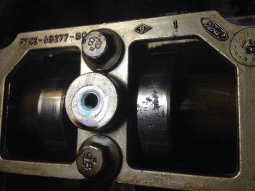

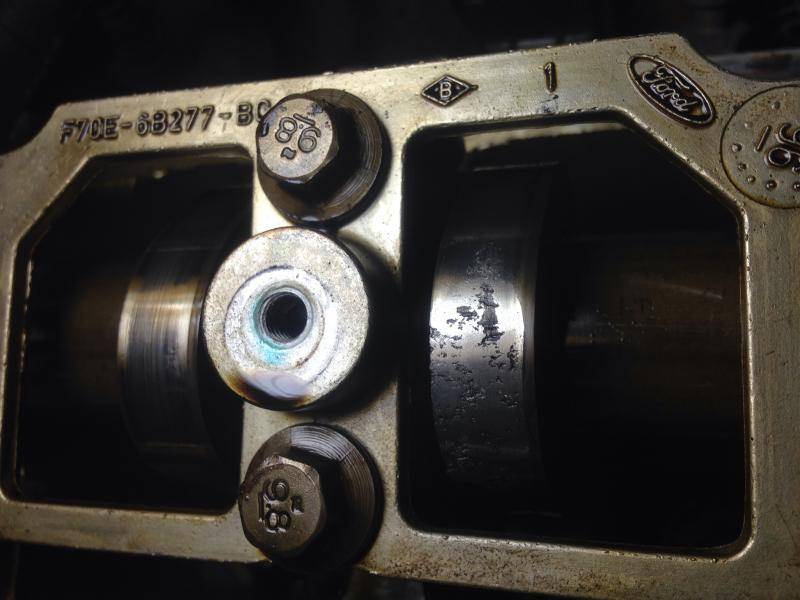

This is one of the damaged cam lobes on my motor that was making it run so poorly. This is a cam lobe on the intake cam of the passenger side cylinder head
Here is another pic of the tear down so far. This shows the passenger side valve cover off. Like I said previously in this post the primary timing chain is incredibly loose, and was the obvious cause of my start up rattle/knock so many of us Mark Viii owners deal with.
