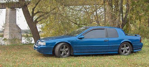

They fit my Cougar, with 255/50/17 rubber, and lowered. 7/16" shim spacer needed, as well as new lug nuts for the LS style wheels.
Chrysler Sebring convertible IIRC has the correct nuts, instead of Ford's :q:q:q:qty mush nuts.
