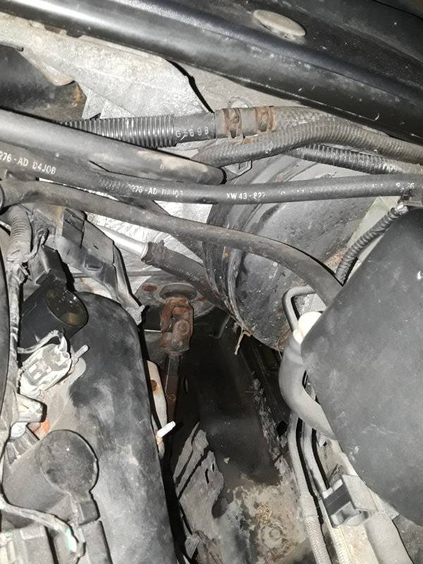

My degas bottle just shit the bed I think. Its pissing coolant from the left side, coming from the black cylinder, not sure what that is.
Do you also have a back up alarm beeping in the cab when you put the car in reverse?
