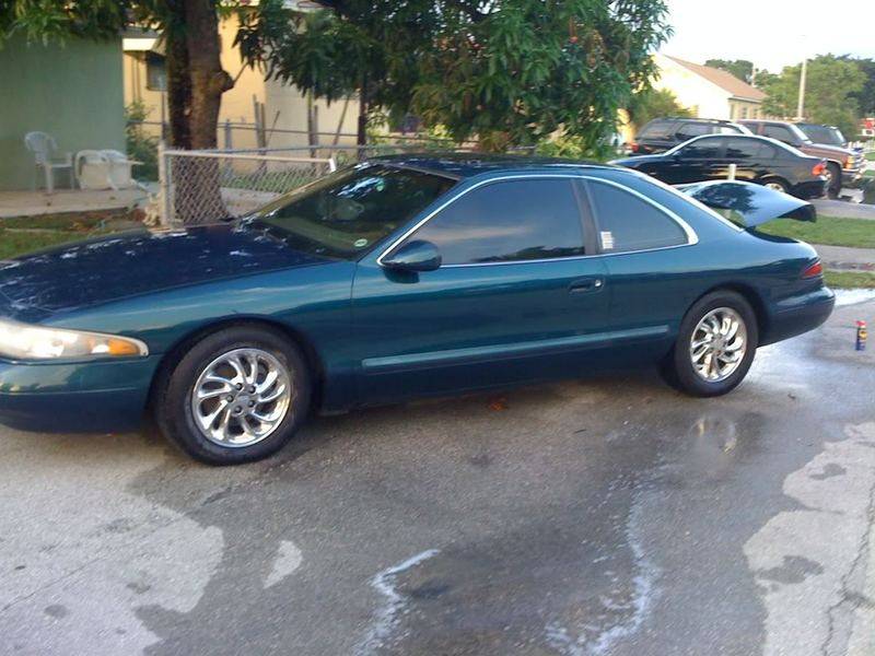

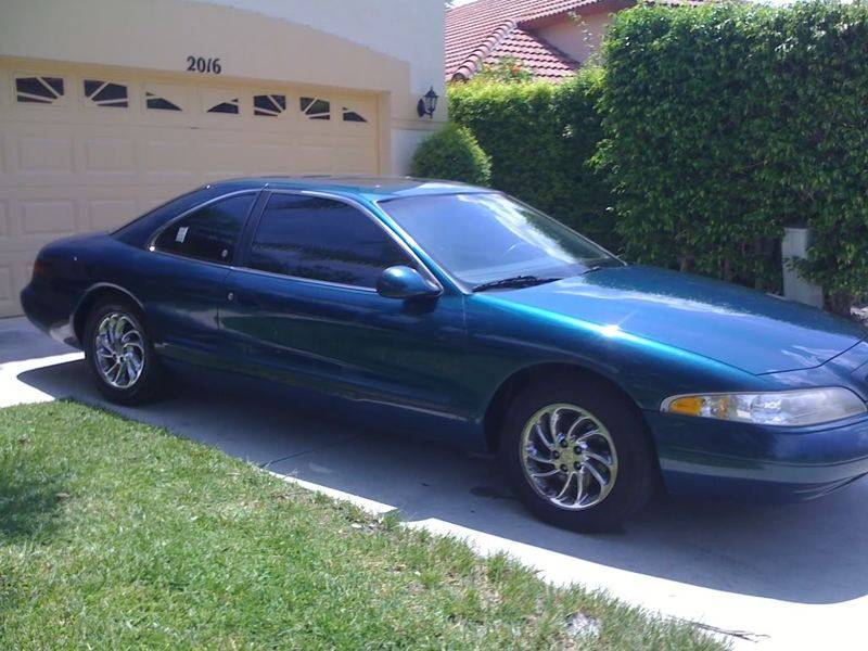

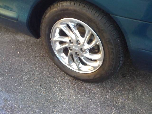

aside from the wheels being on backwards, that is one very sharp Mark!
if i ever get a Gen 2, thats the color i want. or the light green.
:q:q:q:q - I just noticed that.... LOL.. Ill fix it with the alignment
