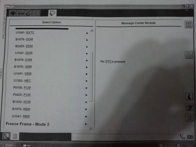

As for the Check Engine Light, all I can do is "LOL" at this. I knew it was gonna be bad, but DAMN!
U1040
B1676
B2425
U1041 (Again)
B1676 - DFM
B1676 - GEM
U1041 (Again) - GEM
U1262 - HEC
P0156
P0420
B1932
B1676
U1041 - REM
(Yes, 13 codes :D WONDERFUL!)

The free scan and possibly your scan tool would only have picked up the "P" codes.
U1040 - comms bus fault. This may not really be a problem. Random bus faults every once in a while happen even on cars with no problems. They sometimes cause "mystery beeps."
B1676 - Battery voltage out of range. You could have some loose wiring or a bad battery.
B2425 - Are your heated seats working?
U1041 - No speed data from the ABS module received at some module (you didn't say which module each code came from.)
B1676 - Voltage warning from another module.
U1041 - No speed data from the ABS module received at some module (you didn't say which module each code came from, no GEM on the LS. Maybe it means the FEM, front electronics module.)
U1262 - Comms bus fault.
P0156 - PCM does like what the driver's side post catalytic converter O2 monitor is saying.
P0420 - not happy about the passenger side catalytic converter either.
B1932 - Driver's air bag open circuit, probably the clockspring.
U1041 - No speed data from the ABS module received at the REM (rear electronics module)
The fuel filter is in the driver's front wheel well, behind the cover. Yes, it should be changed, but it's unlikely to be your stalling issue.
Looking at this the VERY first thing I would do is find out you voltage issue. What your voltage before you start the car and while the car is running is. If you have a charging problem or a bad battery and fix that the most of these codes could go away.
Basically, you can't really know what's happening until you know you have a good battery and you charging system is working properly.

Got a new battery just now, just went to AZ and got a Duralast Gold (Ive replaced 2 of my previous Explorers batteries with DG's and LOVE them), the old Motorcraft from '05 had a red eye (That little thing thats green if its good, red if bad), and they tested it and told me it was at like 9.9 volts....:) I was like yep thats gotta be the culprit.
Wires all look new still, no corrosion, etc so we'll see what happens.
(Threw the battery in and she cranked twice as fast as normal. Airbag light still on, but im pretty sure thats the clockspring; no CEL codes yet after it ran for about 30 minutes, which is expected but hopefully most of those codes dont come back)
