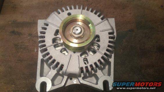

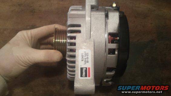

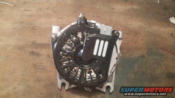

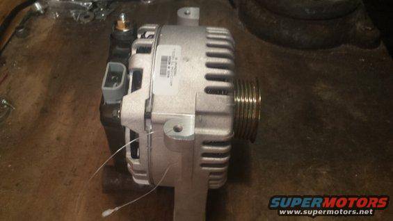

In the meantime, here are some pictures of the alternator I purchased.
I wish all alternators were that easy to replace! Even with putting tools away and testing I was under one hour. The old one would make bearing noises when spun after I got it off so it was definitely a goner. As if the video I made a couple of weeks ago of my volt meter having 12 volts not prove the point. Speaking of video, here is a quick video of the alternator putting out 14 volts. I will be taking it to downtown New Orleans tomorrow, then the West bank, to Metairie, back downtown, up to where I live then, into the town of Abita Springs ... I expect to put 125 miles on it tomorrow for the alternator's maiden voyage.

I usually go down to the local machine shop and have them bench test new alternators a couple of times before I go through the effort of putting it on. But yes, the Mark VIII makes it wonderfully simple to replace the alternator, nothing needs to move or is in the way.
