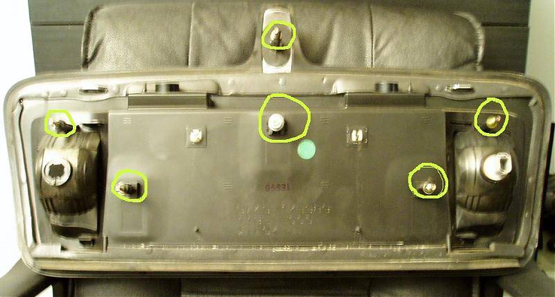

Actually, it's kinda a PITA... there are nuts that hold it on, you have to open up your trunk, pull the carpet from the backside of the trunk and you'll find a few nuts that hold it on. The carpet is the hard part; the push things they use to hold it on are a royal pain to get off without totally mangling them!
Yeah, what Nate said. It's 6 nuts.
Here's a picture of the back side of it to give you an idea where they are:
