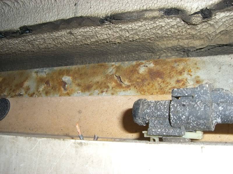

Anyway today was the day I decided to figure out why my plate light would not work? I got my probe and my Fluke out to test what the deal was. I find that there is nothing from either light socket connector :confused:
So I oped up the back of the trunk to follow the wiring and see where the opening is in the circuit. Cannot find anything wrong but I also can't get a reading from the light socket to the wires in the trunk. I mean nothing at all and it was driving me nuts! I go under the bumper as I was going to run some new wires and just link them with the side marker light. Upon dong that I found this under the bumper.
That is the clip that goes to the plate light from the body into the bumper. Seems something ate the wires off flush! So I clipped off the factory black clip in the picture and butted the wired right to the chassis wires. Works now but I have to figure out what or how the old wire disappeared :shifty:
