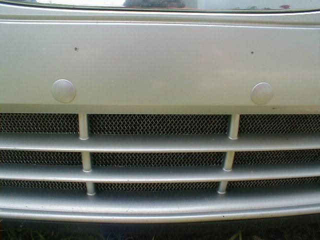

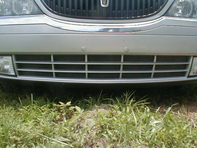

what a chore that was. you have to drill out the rivets. its a pretty big drill bit. once thats done i got the little interior snaps that pepboys or advanced auto sells. they come black so then i painted it with the touch up auto paint that comes in a spray can. ill post a pic in a couple mins

Holy $hit.....that was intense. i was so worried about hurting my babay the whole time. I didnt have quite a big enough drill bit so there was some metal still attached to the rivet....had to slowly saw it off with a mini-saw. well worth it though. looks great
