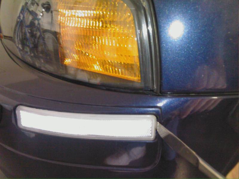

Anyone else notice the fit isn't as good as the originals? The end that doesn't have the metal spring clip is hard to fit in, and that side stays bowed out more than the factory light does. Drivers and Passenger side fit the same. I put it in anyway (I did use a dremel in places, but I didn't find exactly where the issue is to make it a proper fit).

No need to take the bumper off. To remove use a butter knife and insert it between the lens and bumper at the edge facing the rear of the car. There is a metal spring clip that will release and then the lens comes out.
To put it back in, I had to remove the 3 bottom screws of each fender well under the bumper and one screw in the fender wheel well where the bumper meets the fender... and reach in to hold the bumper tab when inserting the light for the metal spring clip to click in place. Put the 4 screws per side back on. Done.
