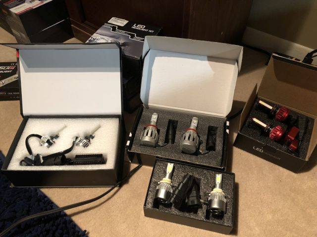

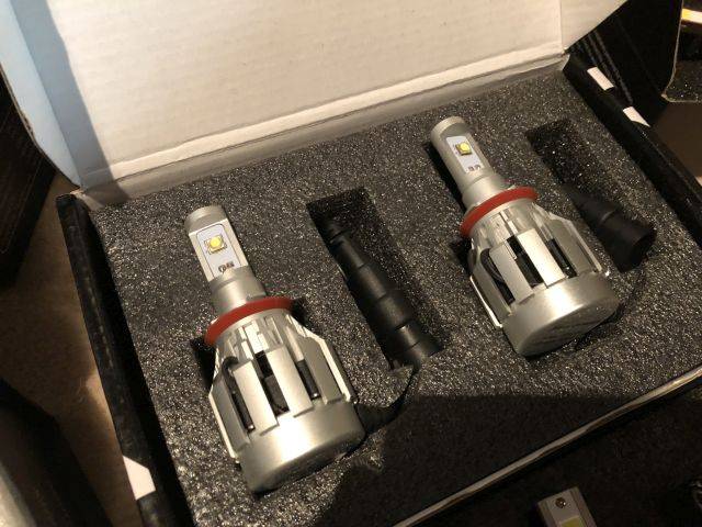

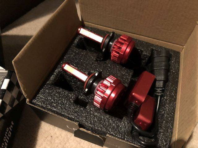

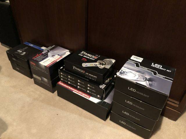

Small collections of bulbs I had been experimenting with.

Thing to watch out for with all these LED bulbs for sale on both eBay and Amazon is that there are many vendors or sellers that are doing Private Labeling from China. If you look close enough at all the ads, you'll possible note that they are the same bulbs but with different packaging and name branding.
I also found that after 40W 3600Lms @ 6000K white output per bulb, they are all the same. Such a small difference it's barely noticeable or even any better/worse.
I picked up a cheap set that promoted in the ad that they were 100W's a set, meaning 50W bulb per side but they were cheap Private Labeled brand and total garbage. For one, it was slightly less bright then my best set and second, one bulb, the fan would shut down after about a minute and thus turned the bulb off due to excessive heat. Some sort of thermo problem. I managed to get my money back on those on a return. I claimed they were false advertising and simply defective out of the box.
I've also picked up a set, although good output and clean spread, they fans' are very noisy compared to other Bulbs I had tried. Not a huge deal, good output was more important than fan noise which you'd not really notice once the hood is closed and going down the road.
It's tough to do a recommendation of brand names, there are a couple good big brand name LED bulbs available but I can not understand why they'd want 100 to 150$ a set when the average pricing all over Amazon is somewhere between 50 to 80$.
I just settled for what I had already purchased, it wasn't going to get any brighter.
You'll want to watch the size of the cooling fans on the back end of the LED bulbs, you'll need the room to keep them inside dust covers or lamp assemblies.
