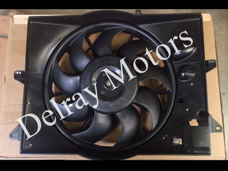

Here is a stock Gen 1 fan+shroud
Stock Gen 2
What you can immediately notice is that the stock shrouds are wider than they are tall. Now, I can't currently measure the dimensions of my stock hydraulic setup, but the 168 is barely wider than fan itself. Sure, you could probably mount the 168 sideways, but it's still smaller than the 180. The FaL 160 instructions mention filling in a bunch of gaps. Some things to consider...
