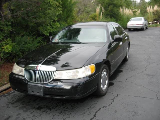

also you need to post pics
gotta detail it still

Love it, very nice ride, throw a black soft top on it and I own the same car.
