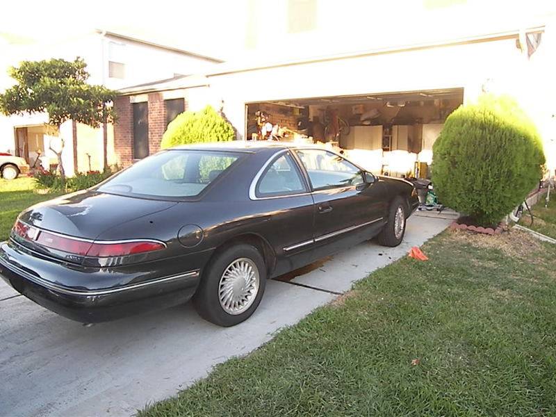

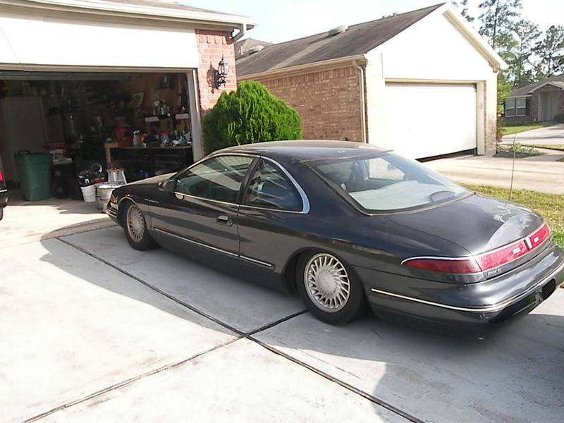

Well been having the usual issues with the air ride ... so not too suprised today to come outside and find the front of my mark with a good 6" inches of space between the tire and the fender.( Didn't know they could go up that high.) Also the compressor was still running. Wasn't sure what to do to turn the compressor off, so I pulled the battery cable. By that time the damage was done. So as the day progressed, I watched the front of the car slowly drop. Started the car a couple of times to see if the compressor would come back on. (no luck on the compressor.)
I've known for a while that sooner or later this would happen. Couldn't decide whether to go Coils or fix Air ride. I guess its decision time now as my Mark is on the ground. Probably going with coils.:D
Just posting this, so some can laugh at another one of us who waited too long to make their decision. Now I get to bounce around town in my beautiful luxury sports coupe.

Before
After
