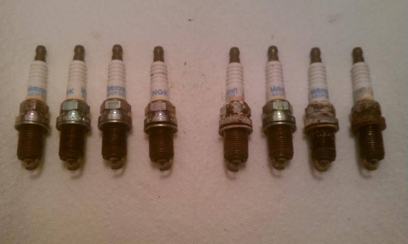

I didn't have any luck with NGKs in mine either. A month after I installed them I was getting misfires in 3 cylinders so I thought it can't be the plugs. Replaced the cops on the 3 cylinders that were misfiring and no change. Went back and got autolite plugs and installed and all was good. Now here it is 3 months later and I'm misfiring again. No part store that I have gone to carries motor craft plugs that I need.
Aren't OEM motorcraft plugs NGK?
Thats what I pulled out of mine when I replaced the plugs and coils.
Yes, and that's what I've used as replacements. No problems other than I had to adjust the gap on a couple of them.

I've been running NGKs for about, wow, about a year now. Didn't realize I've had the car that long until now. No misfire problems since the plugs were replaced, all gaps were verified before install. However, NONE of the plugs had the correct gap for the LS out of the box, every single one had to be gapped.

checked the gap on the new NGKs and low and behold none were at the correct gap. gapped them to 1mm and no misfire at all now. Not even while at low rpms pulling hills. Thanks guys for the info.
