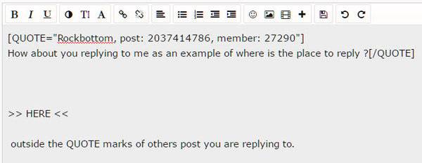

Try typing outside the QUOTE marks within the reply field. Basically at the very bottom of the peoples quotes you are replying to. Not sure why you again are including me in a quote when your point is directed to the OP. Did this in another thread also. A bit confusing really.
Not trying to bust your balls here Rock but see what happens to your text when you reply inside others quotes. It gets buried and hard to follow along.
right after: Re&Re - OEM Degas Bottle - GEN 1 V8 >> your text starts ...

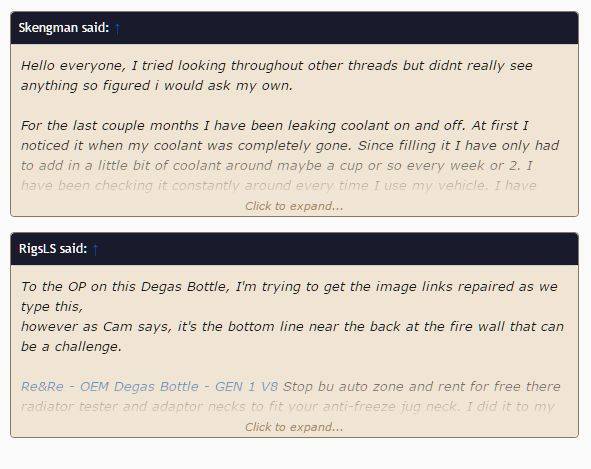

Not sure if you were trying to tell me something related to my link I shared which was information about the Degas bottle ... or if you were attempting to tell the Original Poster (OP) that he should do a pressure test at the bottle instead ... or something else, like perhaps you thought my link needed editing to include your Autozone rent free pressure tester or the fact that you wanted to correct me by stating that we should pressure test before removing the bottle. I honestly don't understand when you quote like this. Happen last week in another thread as well and I'm sorry I didn't get it that time either. Don't mean anything with it, just perhaps try to reply to others outside their quoted marks.
