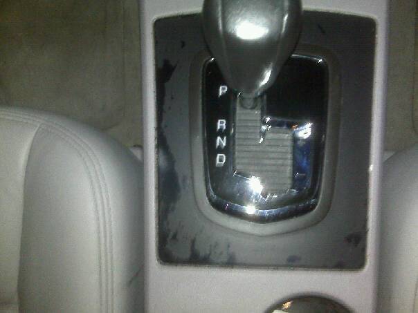

yeah, i agree. please get better pics for us to see. but that really looks horrible (peace!)

Remove it, scrub it with dish soap ( to remove armor all...), wet sand it with 400 grit wit a few drops of dish soap in the water until it feathers out or until you get all the old paint off, sand it with 600 grit, wipe it down with wax and grease remover, mask it off, paint it with SEM or other interior rattle can, de-mask, reinstall.
