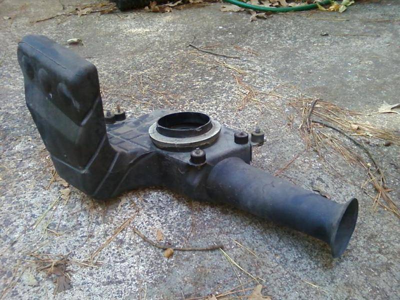

you can fab up some kind of conical filter and box and attach to stock tube to throttle body...but gains are basically unnoticed...also remove the air silencer at bottom of airbox that bolts in through inner fender...
I have only removed silencer...cars seems to perform well in all temps for me
Take out your inner fender well shield and remove the air silencer, and re-bolt in the filter box assembly. This will leave a nice big hole for air to go thru to your filter. It will also make it easier for you to replace your air ride compressor when the time comes. Reattach your inner fender. This will provide you with all the air you will need without sucking in warm engine bay air. Install a new stock filter and you are good to go. For looks you may want to cut off some of the intake tube appendages and reseal (glue) the openings shut.

I'd just Leave it, k&n will cost a bunch of money and drivability issues if over oiled, a cone filter will suck in hot engine resulting in a loss of hp and create nox. My car get 33 mpg and run mid 14s with the stock air intake assembly. So I ask you why?

The one I have been working on had that set up when I bought it. I returned it to stock minus he silencer and the resonator.
snorkel delete, aforementioned

Remove the air silencer attached to the stock air box

Removing the snorkle is still your best bet
