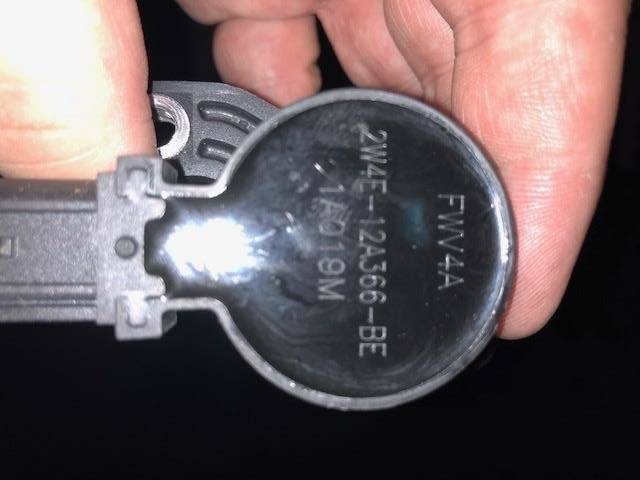

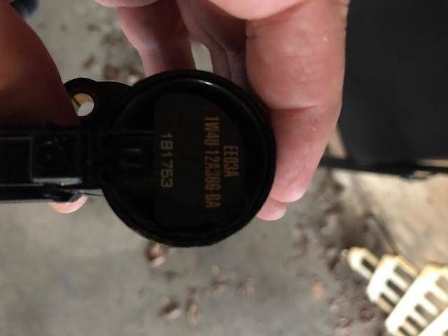

Also, i found 2 different types of coils in the engine. The pics are attached. Is this normal?
Thank you, Joe. Also, i found 2 different types of coils in the engine. The pics are attached. Is this normal? View attachment 828570175 View attachment 828570176
Well, it came from the factory with all the same part. They have probably been changed a few times by now. Personally, I'd put eight new Motorcraft coils in and then probably never have to worry about coils again.
Well, there was someone who posted 120K miles on Borg Warner and a local store here has them at a good price and the store warranties them for life. I replaced 7 and I am waiting for # 8 to come in. Should be a few days and then they will be all the same.
