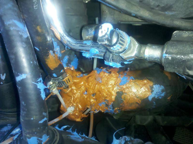

i have a quick fix for this. it just happened to me this week, it requires a 1/4 inch t fitting 2 tie straps. sealant and a hose clamp
trying to uplaod a pic.
well if thats the same hose. upper radiator
hose.i had to buy mine on ebay for 199 then paid like 35 shipping to hawaii.. ford in hawaii tried to charge me 390.. i replaced my coils and the guy here on base at the workshop broke of the tip of that part. so i was out of luck. i finally got my part in. im going to install it this weekend... but this contraption i put together works well.. i tried just capping of that part but the overflow hose was spitting out fluid. this was the best thing i could make work.. it actually has held up , no leakage for 2 weeks.. i got a 1/4 inch tube.... i cut into where the tube going out was and i put the 1/4 to 1/4 plastic tee snub. then i got zip ties and i used the blue sealant maker. and it works.. any questions on this quick fix. p/m me... by the way im brand new to the site. my name is thiago. im stationed in hawaii and i drive a 2000 ls v6. i just found out about this site this week.. i will be posting here a lot and try searching previous
http://cgi.ebay.com/ebaymotors/ws/e...ageName=ADME:X:RTQ:MOTORS:1123#ht_1827wt_1167
my fix for the upper radiator hose.. no dealer in hawaii had it . and i had to do this to keep my car running
