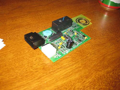

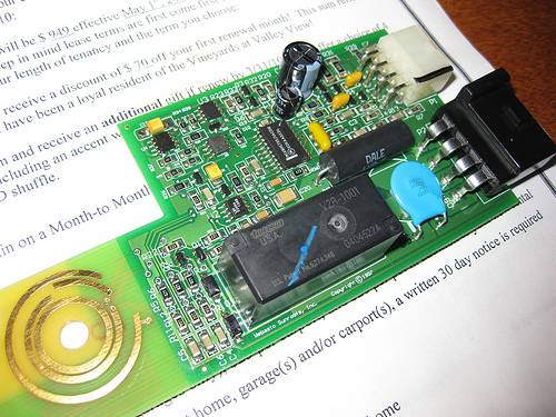

I'm currently holding the circuit board that controls the sunroof motor (wanted to inspect) but I dont know how to test it. Nor do I know how to test the sunroof switch.

In case anyone wants to see the control module out of its plastic box:

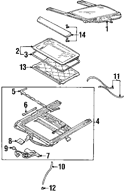

It fits into the sunroof (part #8) as illustrated in this graphic:
