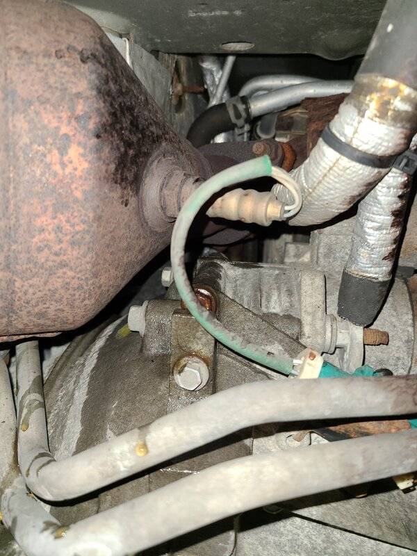

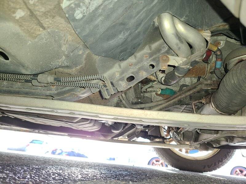

Coldest day of the season so far and found a huge puddle actively dripping under the passenger side of the bellhousing. Looks like it would be directly under the glove box.. I literally just replaced radiator and rest of the system not too long ago.. no idea what this would be. Hoping not the heater core..
On the lift and shop tells me its most likely the heater core, hoses are dry. Referred to a shop that specializes in this heat/ac. I assume its not going to be worth the price and bypassing it will be easier. Not sure if i want to remove the dashboard, one thread on here says its a 4hr job apart and 4hrs to replace. Unfortunately it is winter.
I know there is a tube that runs under the intake manifold but that was recently replaced with the rest of the system. I assume there is an orifice on top of the trans? Not sure why the core would leak there and not inside.
I also noticed without the heat on it is not really leaking. Does the DCCV cut off coolant to the core when not leaking?

I'm not sure if the dccv completely shuts when the datc is set to off but possibly. Try putting the heat setting at the lowest to see if it stops the leak.
Did you look at the end of the three metal tubings if the leak is coming from there? Right in the back below the heater core just folow the rubber hoses from the core to where it joins to the metal tubes
Follow the number 13 theres a rubber elbow where it joins to another metal tube further behind the engine
The DCCV can't shut off all coolant to the core, because the return line is always open, and the system being pressurized would force coolant out of the core the whole time the engine was warm.
Coolant from a heater core leak would come out of the AC condensate drain tube.
Coolant from a leak at the front of the engine or under the manifold will come out around the transmission bell housing.

Where is the AC drain tube exactly? I did not see that. Never have actually.

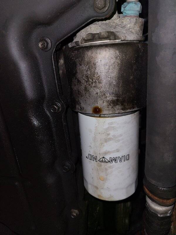

This was by the bell housing and I just noticed the oil filter dripping antifreeze as well but the leak in back is dry right after driving.. for now..
The car was parked nose up tilted to the right so it would explain the passenger side leak by bell housing before. The degas level barely dropped.

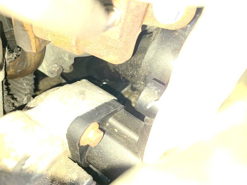

Motor reaks of anitfreeze and noticed a drop or three drying by the thermastat housing on the hose that goes to the lower radiator.... nothing on the manifold.
It seems it likes to leak once luke warm? I had this same issue though barely as bad a year or two ago which took me forever to find.. and it was the O-ring between the two plastic thermastat parts.. I bet the coolant cap from being so hard to turn was enough to break the O-Ring seal again when I changed the radiator. Had to use Channel Locks to remove it.
I went from DCCV to Radiator now possibly the O-Ring again. I knew after the radiator it would find the next weakest area.

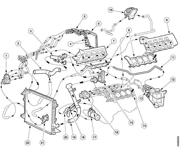

I would love to replace it with the Jaguar housing which uses the yellow clip to solve this before I don't feel like removing the manifold so will resort to the O-ring and sealant once again.
If i were you i'd clamp the heater core inlet hose and the return hose shut with vice grips to see if it still leaks and if it does then its not the heater core. Then from there just check every hose

See my post above. Yes. Im not sure why the caps get so hard to turn? Probably the pressure of turning that with pliers was enough to break the already weak seal that is now under full system pressure now that the radiator isn't leaking. I just noticed some white residue around it and the old sealant popping out. Will change this O-ring anyway.

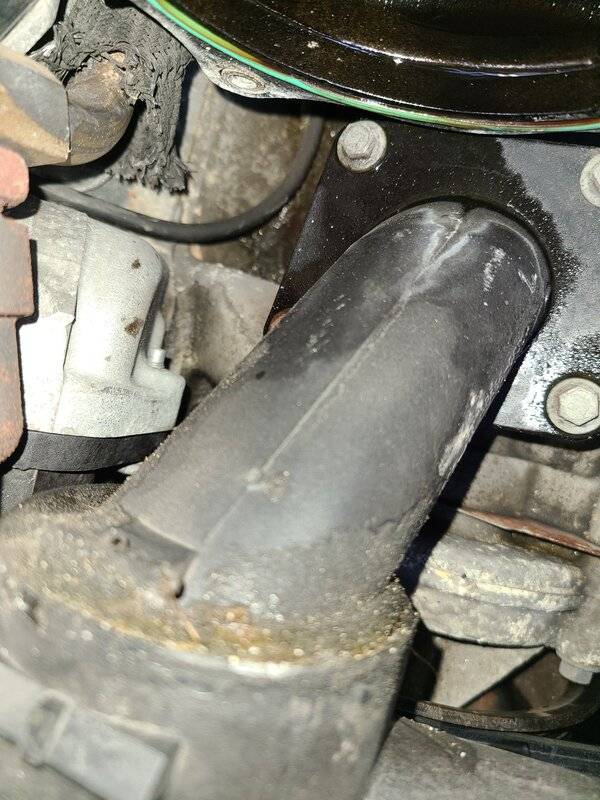

Hard to see but after cooling down the entire manifold is under a puddle of coolant and the O-Ring once again is blown.. $8 fix but sucks.. bad design. 3rd time replacing.. I will hopefully find the Jaguar housing with yellow clip for next time if there is one. If you look at the top of it you can even see what looks like something was forced out if it.. i assume either these pieces were defective or just the design sucks or both. Still dont understand why the Jag housing has the clip and ford doesnt.
ALL coolant parts are FORD. Just like my ford alternator that needs to be replaced again (bad bearing). Almost wonder if some aftermarket parts arent as bad now. Perhaps the plastic was a bad batch or warps over time. Or the LS usually has so many leak points it never blows for most people. Its like the system needs a weak point to relieve itself. Almost afraid to fix it and the next part blows.

If I hadn't traded off my LSes, I was probably going to try the Jag coolant parts the next time around. Unfortunately, I don't think you can tell if they will really fit or not except by trying it. You might have to change a hose or two as well to get it to work.

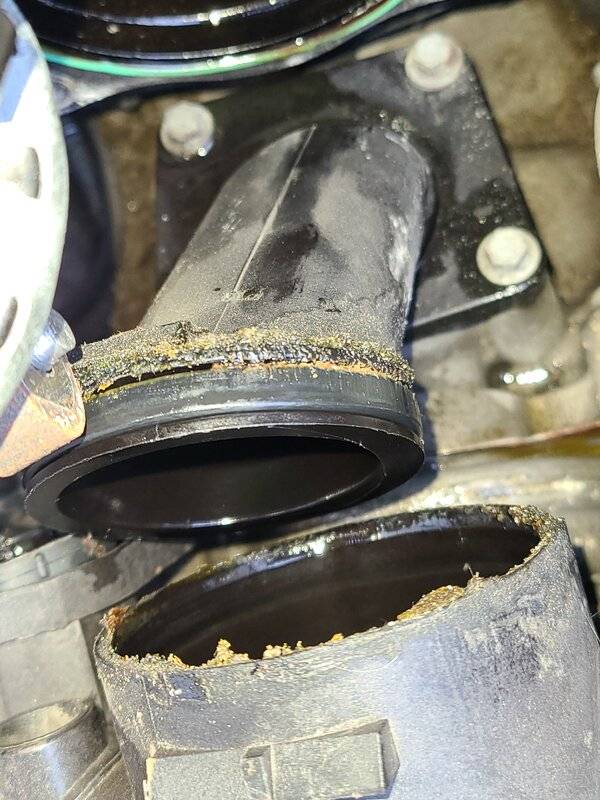

Replaced the $7 o-ring and the two gaskets on the crossover piece that bolts to the face of block. Screws seemed very loose once free.. the o-ring had a date of July 2021 stamped it so its still new. Poor design.. I assume the crossover piece expands over time from the pressure of the o-ring and helps it leaks easier. Next time will be replacing the crossover if its not obsolete..

With that o-ring... it should be lubed with a little coolant so the elbow seats fully and properly in the crossover. Half the time... if you install it dry... it will end up leaking.
Best to assemble the crossover pipe and elbow first (after lubing the o-ring) and installing everything as an assembly.
89 inch pounds of torque on the bolts. Almost all cooling system bolts are torqued to 89 inch pounds.
