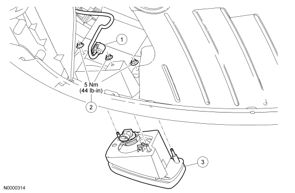

Removal and Installation
With the vehicle in NEUTRAL, position it on a hoist. For additional information, refer to Section 100-02 .
Remove the 3 nuts and the fog lamp.
Disconnect the electrical connector.
To install, tighten to 5 Nm (44 lb-in).
To install, reverse the removal procedure.

Wrong instructions for the '06. You need to remove the platform/bracket that holds the lights. IIRC, there are 3 or 4, 4 or 4.5 mm bolts. You will get a better idea once you're under there. Unplug the light and remove the bracket. The lights are held in by 4 bolts.
They are glass, so refinishing may be difficult. I replaced mine for <$80 shipped from Tasca.
Crap I didn't even realize that. Those are the non LSE fogs. Weird since that manual is for the 06
