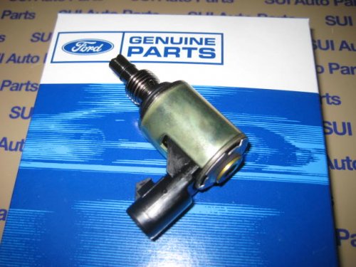

Solenoid looks like the following image:
5. Once you spot this get your T40 screwdriver or socket ready. Now have 1 person on your left (left side of the control arm) feeding the screwdriver or socket through and you (on the right of the control arm) guiding it into the solenoid. The person on the left should now unscrew the solenoid until it is all the way out.
