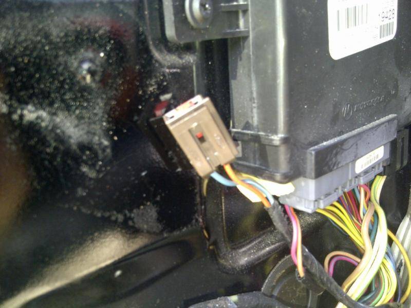

Here is a plug under the door panel not plugged into anything?
Anyone know what this goes to?
