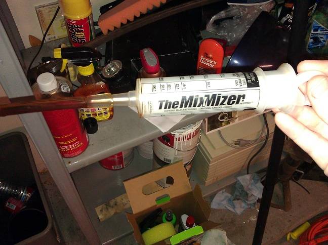

There is no drain plug.
I got this think at Wal-Mart for about $5.
Just stick it in the tank and suck it out.
Wow - no freekin way - its a good job i asked because there are two large nuts under the steering rack and I wasgetting ready to crack one of them to see what came out...
Thanks for your help - so I guess everyone seems to be using mercon five or mobil 1 - when they are talking about flushing, I am assuming that just means repeated fluid changes by sucking it out ofthe resevoir...right...?

I'm using Mercon V.
Just suck it out of the reservoir.
i used a turkey baster That i got for a buck or 2. Though Stones solution looks alot better.
