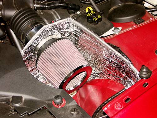

here is an inexpensive heat shield that keeps the low speed heat soak down. It is made from foam insulation from hardware store. I has lasted over two years now. Before shield the metal on the KKM filter was too hot to touch, after the metal is cool.
