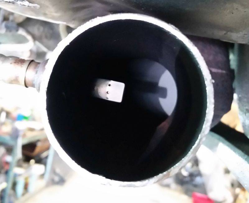

As the system was cut off and the inside of both CAT where blown out, car lowered onto the ground and a good few hard revs blew the remainder out.
Both Screens inside each CAT are in perfect condition after all, nothing was clogged up or deteriorated, a good blow out and it was decided to NOT gut them after all.

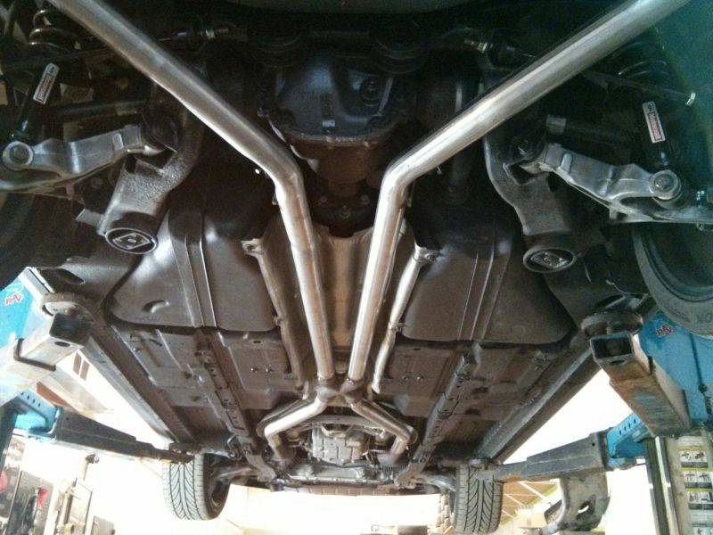

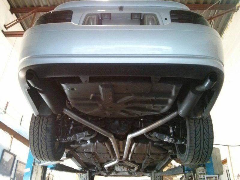

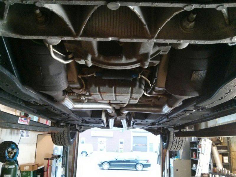

Nice symmetrical new system put back in place
Much cleaner job, just the tips turned out a little on the small side for me, will need to have them redone a bit.
At least the large chrome cannon tips are off.
