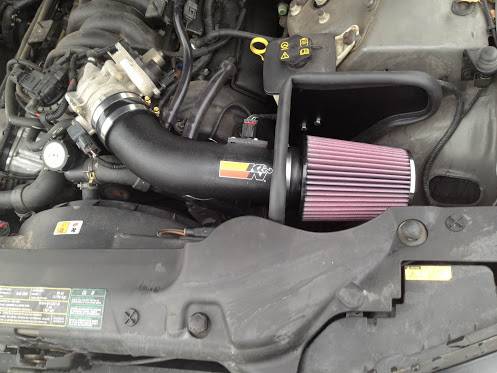

Just looked at the price of a new air box and $376. That's some expensive plastic. Perhaps I won't need the whole kit though and they can just replace the broken part cheaper.
Any reason I shouldn't go this route: http://cgi.ebay.com/ws/eBayISAPI.dl...akeTrack=true&ssPageName=VIP:watchlink:top:en
I'm going to of course wait until I know what the other issues are.
Check out LKQ (or LQK, I don't remember) for a used one. As long as your state doesn't care about aftermarket intake systems (CA does :mad:) I would go with the K&N 57-2562.

I got the car back on Thursday from the dealer. Today I put the K&N CAI intake on replace my broken airbox.
Check engine hasn't come back on yet for system too lean, but dealer told me it may take a few key turns to register that code if the problem persists.
