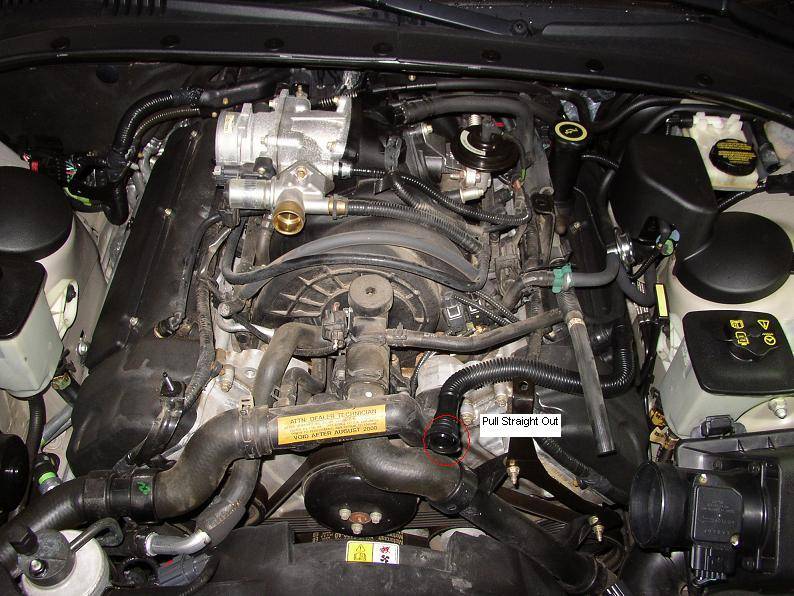

Cool thanks. I know what/where the TB is located. Still not positive on the IAC though. Looking at this picture:
is it the part just in front of the TB with the gold valve opening facing the front of the car?

Yes, you are correct about your location about the IAC (has the gold piece where the tube connects to).
I believe that they require an 8mm socket if I remember. There is a small gasket behind there, so be careful taking it off if you don't have an extra.
When you take it off, you will see a small disc in the IAC that probably will have some black dust on it. Clean it with throttle body cleaner, but be sure the cleaner does not go toward the sensor end.
