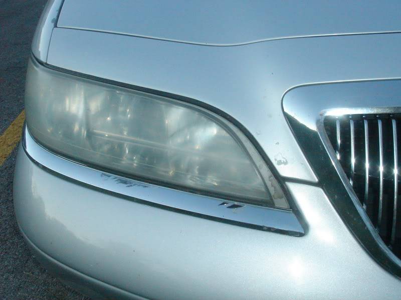

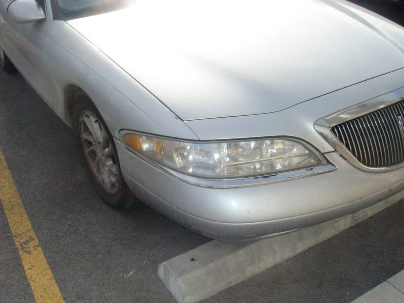

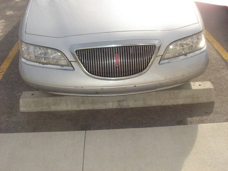

I tried wet sanding and using different types of polish, it worked a bit, but still wasnt great. Then last week at work (carquest) we got a new headlight cleaner kit in. I bought it for $15. It came with 1500 and 2000 grit sandpaper squares, and a tube of polish. I re-sanded them and buffed with the polish, they are perfect now. I suggest just buying a kit like I did, no other polish can compare to what they come with.
Ill get some pics up here in a bit.
This is after wet-sanding and polishing twice, once using automotive car polish, the other time with meguires plastic polish
This is after the "kit" that was purposely put together to clean headlight lenses. It was made by Bright Solutions Inc.
