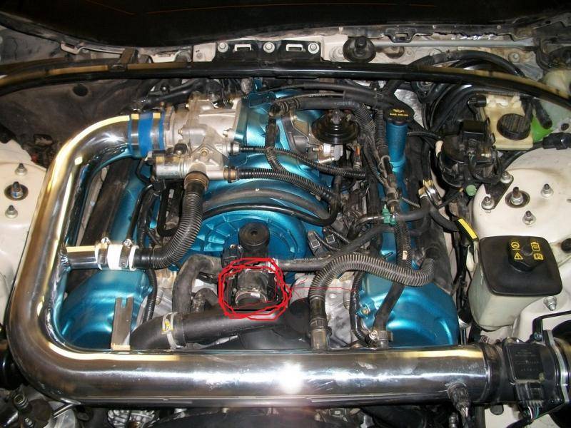

engine.jpg not my engine using out of convenience the hose circled I have searched for a part number even a reference too ...help me out and point me in a direction..
Since you don't say, I'll guess 2001, since that is in the middle of the gen I run. XW4Z-8K576-AE
Are you sure that it's not really the thermostat housing and/or the coolant outlet tube that you really need?
sorry yes 2001...um no I'm not sure, but that hose is definitely blown out... I'm also replacing the lower radiator hose and the degas bottle...I found leaks in all of these locations specifically. Basically I'm just trying to get her going with out overheating,,,thanks for the part number...
You would be wise to replace the rest of the plastic parts too, especially the thermostat housing and fill cap.

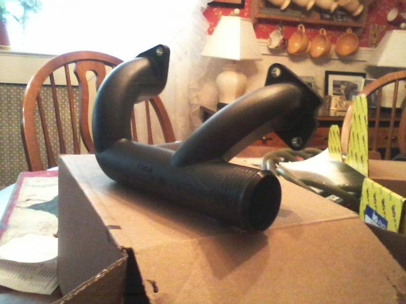

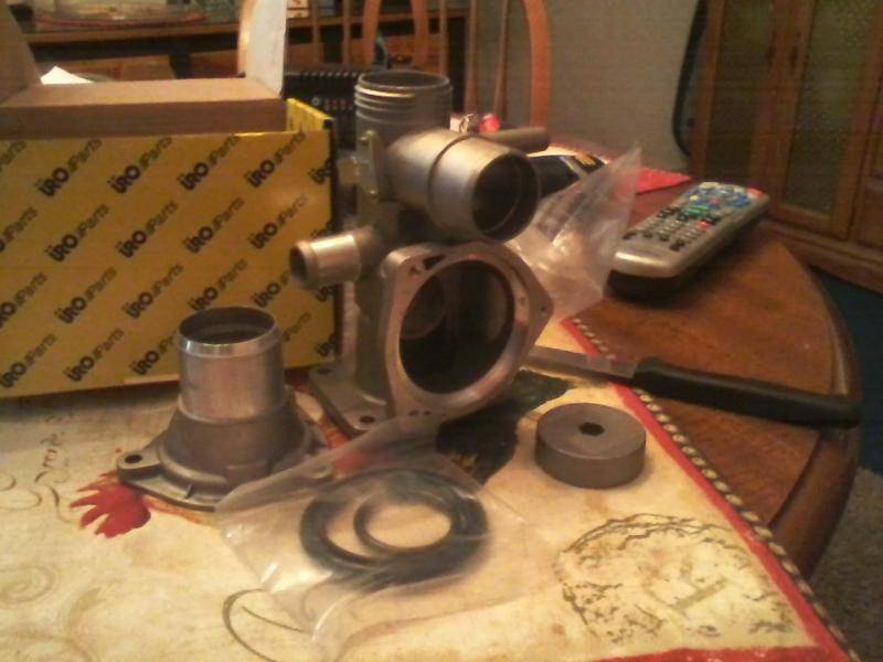

0521151615-00.jpg0521151614-00.jpg HEHE yup replacing more parts I ended up finding a leak in the thermostat housing inlet I'm replacing the cross over just because...
trust me, there are three type of cooling systems parts on these cars...
first uyou have the parts that have failed and started leaking.
next you have the parts that break and start leaking when you take it apart to replace the original bad parts.
finally, you have the parts that will fail and start leaking in a week or two...
do yourself a favor are just replace them all now, instead of continuing to have to replace stuff and overheating for the next few months.
