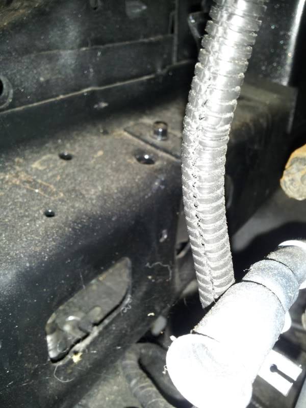

Connects from passenger motor mount lower bolt to .... here... I'll take a pic of where it SHOULD go, I moved mine
I'm pretty sure it was the tiny hole in the vertical section of frame. I use a 10 awg wire now, bolted to the outer side of the frame rail
+1 That lil bitty hole!
Mine broke, when I first lowered the engine, didn't know it was there, picked up a lawnmower ground strap at a parts store, it worked.
Thanks guys, went to pick n pull today and found right where it bolts up. I'll bolt it up in the a.m. and report back. Hopfully it will help my problem if not I have no clue. I'm going to clean the main harness connecter as well.
