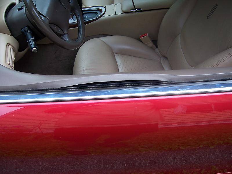

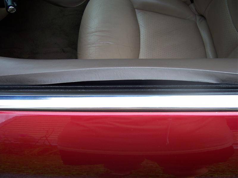

Anyone know of a good glue? The door leather at the top, by the window, became unglued. It has a foam padding so superglue is not going to work,the foam is too pores.

That was happening with my 97, and any of those adhesives will work. It will work best however if you take the panel off and glue it out of the car.

Thanks guys for your replies!..I tried different types of glue, They ether dried to fast or they required the glue to set up on both pieces, making it hard to slide in position. So I ended up using some glue I had for PVC pipe....It worked great, spreads on EZ and holds great!:D
