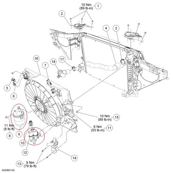

I think I confused you. No A/C leak. If you look under the little a/c resevior thing you will see a box that has multiple cooling lines going in and out of it - I think thats leaking - I also think it has something to do with why I am not getting cold air. I could be wrong though.
See... http://deneau.info/ls/s6x~us~en~file=s6x33011.htm~gen~ref.htm
For a blow up of the engine cooling system. I believe you are talking about the item 12 18495 Coolant control valve
If that is leaking, either the hoses are bad or the valve is bad. Replace whatever is bad. I bet the valve costs a pretty penny or two.
This valve looks like it controls the water to the heater so if it is stuck open, you will have heat all the time.

The DCCV is behind the radiator on the left side, just above the aux coolant pump. Is this where your leak is coming from? (Sorry, but I don't know what you mean by the "A/C resevior" [reservoir, I assume] or "coolant junction box.")

This is not my pic, but shows the part (circled in yellow) that I am calling the a/c reservior. Directly underneath this is a "junction box?" that has a multiple coolant connections in it - I think that is my leak/hot air problem.
Also, whats the container I circled in red? What fluid(s) go in there? I assume this is my overflow for the radiator, and have been putting water in it when needed - Did I F up?
I should have looked at the drawing link you provided earlier.... VERY HELPFUL!
These are the parts I am referring to, mind you that I dont think anything is wrong with part 9, that was just to reference part 12, that I do think is my problem.
so if 12 is "bad" and leaking, could that be my problem(s) ?? How much is that little guy gonna cost?

In answer to your other question, the thing circled in red is the coolant reservoir. It is not an overflow bottle. The LS, like many cars now, doesn't have one.
As for the the "AC reservoir", that is called the receiver/drier, but you are right it is a kind of reservoir, I'm just not used to hearing it called that.
Please note that after the DCCV is replaced, one of the fuses to the climate control may also have to be replaced. Most times, the DCCV's fail because they leak a little bit of coolant over a long time and it shorts the solenoid coils out. It sounds like yours went straight to being a major leak.

There is some corrosion on part 12 (DCCV right?). Is the fuse your talking about inline or in the fuse box?
