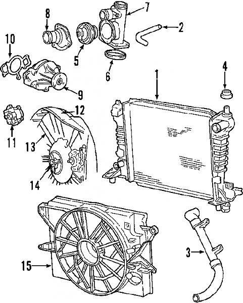

So after replacing the thermostat and cracked degas bottlle....car was running fine for about a week....then it went to $hit. Cars overheating and it has to do with the cooling fan. The fan spins but literally at the speed of a pinwheel in the wind. I mean I can actually sop it with my hand when the cars starting to overheat. Thats how weak its spinning. It stays in low speed and never picks up. My question is would this be the dreaded hydraulic cooling fan issue? What exactly would it be?
14. Fan motor?
11. Hydraulic unit?

The Estate coverage says it covers "Engine cooling fan and motor". Since it just says "motor", I would think that would cover the hydraulic motor. The parts you identified can be considered part of the engine cooling fan and motor.

I had mine replaced
cooling fan motor but not pump. $700 at dealership. The fan was $400 by itself. This is a common problem, they should have recalled the car on this one. I understand that the entire production of the Thunderbird was stopped until they could find a replacement for these crap fans.:eek:
