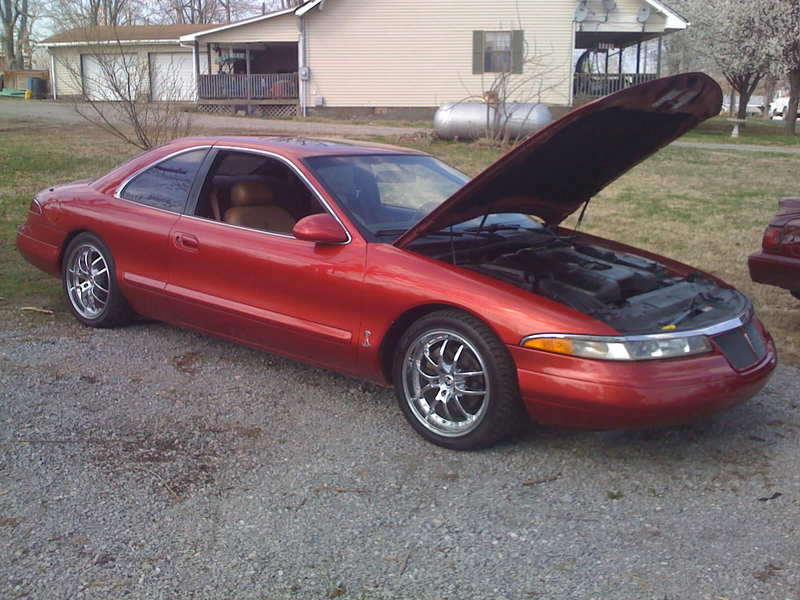

Heres the deal. I bought my 95 a year ago and while looking at it saw it had already had the regular height coil conversion done. I thought whatever... now I wont have to worry about air ride problems. Except now I realize the car must be lowered. What do I do? Cut a coil off each spring? Buy aftermarket springs? Go back to air ride? I would love to go back to air ride but Im sure that would be kinda expensive. About how much would I be looking at? 2 front air struts, 2 rear air bags, compressor is what I would need right? The sensors are still there. I cant decide what to do!!

That would be ideal, but unfortunately not. I have used both standard and lowered coil conversion kits. Both were linear rate springs, both rode ok but handled like garbage. My end solution was to use SuperCoupe springs with Tokico dampers - this kept me at stock ride height, but handles better than the air ride did but at a degredation in ride quality compared to the air. My decision to remain at stock height revolves around the roads in PA being overall crap and the fact that I scraped everything every day when I was lowered. And my decision to move away from the air ride is still one I regret - but, as already cited, since you don't know why the previous owner converted, you run the risk of a very expensive job converting back.
