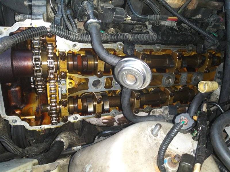

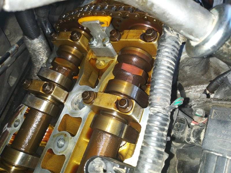

- seconary chain tensioners replaced, and engine supposedly is in time. Condition of primary tensioners not mentioned... and unknown

Are you sure that the primary chains and tensioners are in good shape? As suggested by Joe... a compression test would prove this.
