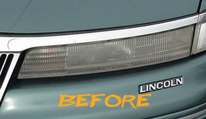

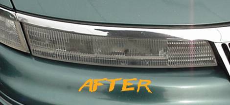

I was wondering if there is an aftermarket solution for our head light reflector problem. I would like to replace the pods and get it over with once and for all.
nope. many have tried, and only ended up with sub-par results.
the problem is two-fold. The area inside the gen 1 headlight housings is too small to deal with the heat generated by the halogen bulb. The second problem is the reflective material Sylvania(the manuf. of the housings) used cannot stand up to the test of time.
many have separated the lense from the housing, and re-coated the reflective surface with either chrome tape, or hi-temp chrome spray paint. This only improved the problem slightly.
My friend bought a brand new pair of headlight housings. They are much brighter than his old ones were, but still pale in comparison to most modern cars.
I suggest either adding a set of aux. lights behind the grill, or installing a 1996 Mark VIII LSC pair of HID's(pricey)

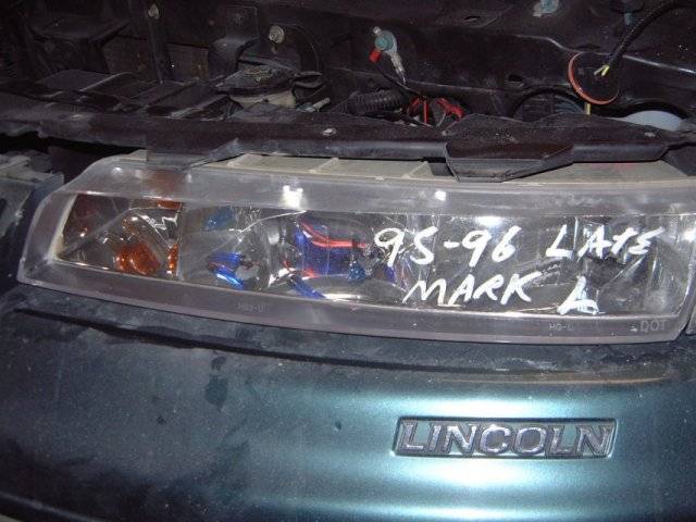

When you go from regular to HID's everything is replaced. So, the housing is replaced as well. The HID lense is a clear plastic, so it is completely different than the base housing lense.
Any used, or even new....after a short period of time, will give you the same problem. Unless you go with HID conversion.
It costs about $600 per side....give Max a call....1-800-866-1520 ext. 236 and he can help ya out.
Here are a few pix of the difference in the lenses between the base model, and HID's....

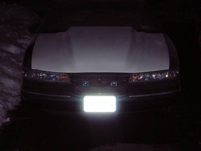

Do you have any more pictures of your car with the HID setup? I am interested to see how it looks with the install complete.

Here are the only other ones I have.... :Beer
