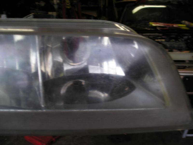

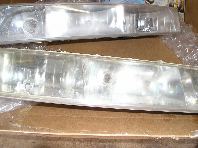

I have gen 1 HIDs and I buffed out the lenses and they came out great, but since they were sitting on some shelf at a yard some were they are really dusty inside. I tried to use warm water and dawn dish soap but it still didn't clean it.
The holes are not big enough to really get a brush or any thing like that in there. Any body else have any ideas. I have the clear lenses part but the reflectors still have this film on it. I will try to get a picture up.

here are some pictures, I will try some iso and see what happens.
