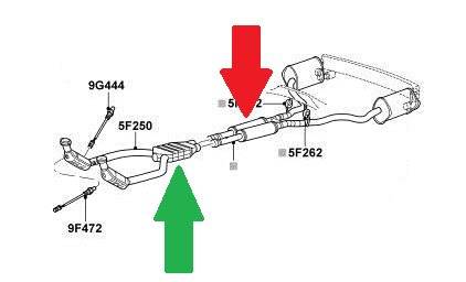

When I was at the muffler shop, they were on the phone with a Ford dealer and also their magnaflow dealer. Both mentioned it was a third cat (where an x-pipe would go). I thought the resonators were the two parts in the back before the mufflers. Which I'm having removed.
See picture below.
For the tips. Everywhere I looked online was $50 plus per tip with $12 shipping. I had one saved in my cart on Amazon for $48 + $12 shipping (4-14 business days). That just dropped to $40 + same shipping. Those mufflers online ranged from $62 and up past $100.
I was told green arrow was third cat and red arrow was the resonators. What's your guys' thoughts and input?
I've never heard of that thing before haha. I must not pay too much attention when I'm under there, when I'm under there, I got it down to not jacking the car up to change the oil so I'm never under there.
The green arrow isn't a cat, it's more of a pseudo X-pipe. The red arrow does indeed point to the resonators.
My muffler guy was uncertain. Would be nice to know though lol. The local dealer here also told him it was a third cat, but half the time they don't know what they're talking about. I'm not 100% certain that they're real certified Ford techs lol.

There are also no O2 sensors telling the engine how the cat is performing. Also, there is no "H" pipe. This configuration was '03 only. Wonder why.........
An old dealer told me the way to get HP numbers was to convert from liters!
My 06 has it...well had it untill i had an xpipe welded in its place.
