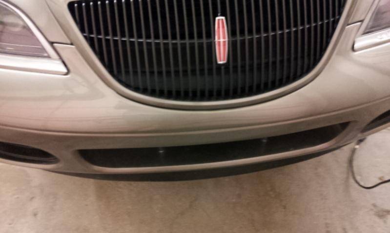

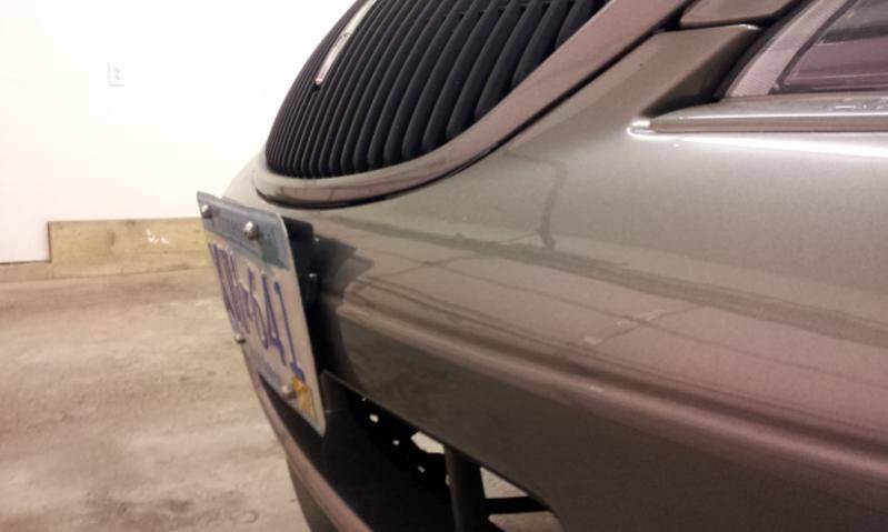

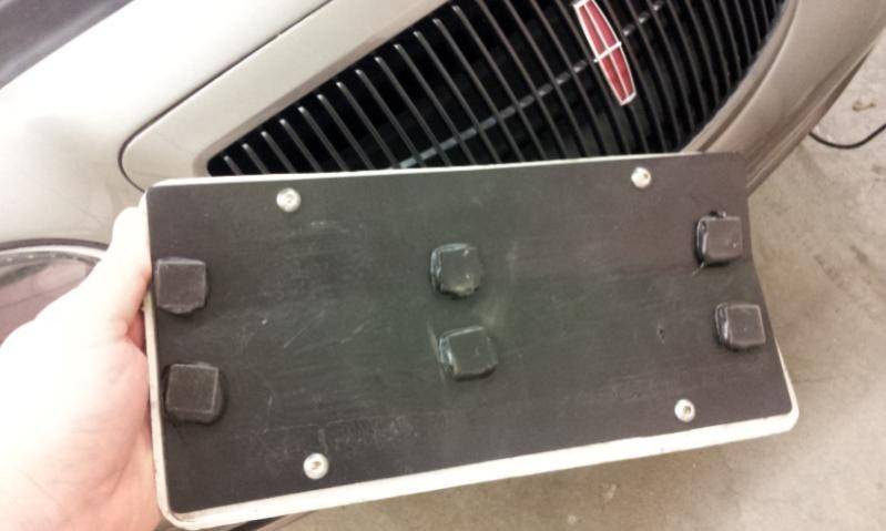

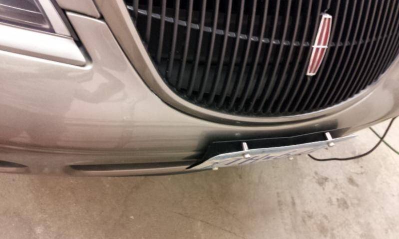

This is how I did it.
Magnets? Or some sort of wizardry? lol.
Wizardry!!!
Lol
I have a magnet mounted on the back side of the bumper in the same locations as the bracket.
Neodymium Magnets N50 1 in x 1 in x 1/2 in NdFeB Rare Earth Block
Neodymium magnets are the world's strongest magnets. All magnets are not created equal! Applied Magnets offers the highest quality neodymium magnets with consistent performance at lowest price. Our strong neodymium magnets are designed & manufactured to meet stringent quality standards using the latest technology.
Neodymium magnets (also known as Neo, NdFeB, NIB or super magnets) , a type of rare earth magnets, are the permanent magnets made from neodymium, iron, boron and other minor rare earth elements.
Super strong Neodymium Magnets Grade N50, stronger than N48, N45, N42, N40, N38 and N35.
BrMax: 14500 gauss
Nickel-Copper-Nickel triple layer coated for maximum neodymium magnets protection and durability
Magnetized through the Thickness, poles are on the 1x1 surfaces
Approximate pull force: over 59 lbs.
did you coat them with rubber or something to keep them from scratching the paint?
