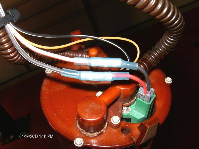

Halfway through fuel pump replacement. PIC

Here you go; the focus pump is a nice upgrade, the check valve is in the line but you dont have to use it; many have done it with no issues. I did but its a pita to get the lines apart. I also used the new sending unit with my old float arm, if I remember right the sender is on the opposite side in the focus basket and the arm swings the other way.. so you flip it over and install it on your old basket.
As for the wires, I always check them but the focus pump is clearly marked; the new pump comes with a new style plug.
I did do this. And kept the check valve.
Like this guy (but with the check valve).
I wanted to use the white socket that goes on the top of the pump since it sealed well and the old one was not so great of a connection.
All's left to do is wire it up (aware of the wire-coloring) and put it back in.
Like this.
Here she sits until tomorrow.
