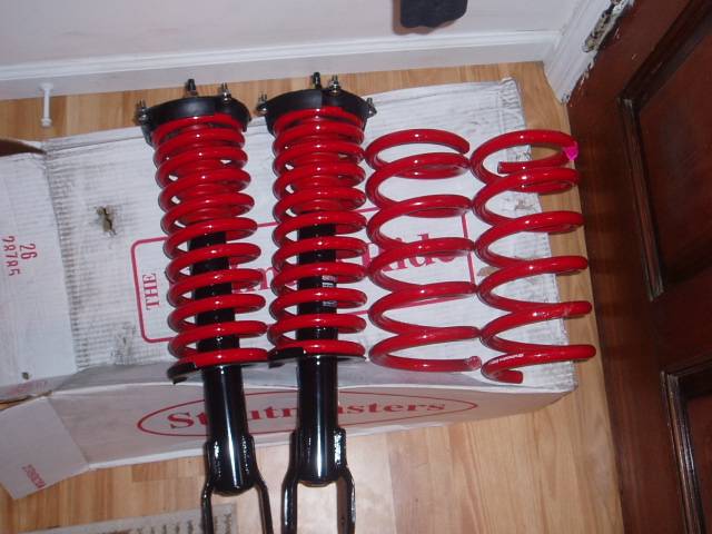

Not sure when I will put them in.. maybe tonight, maybe tommorrow night but pretty soon they will be on my car. here are some pics

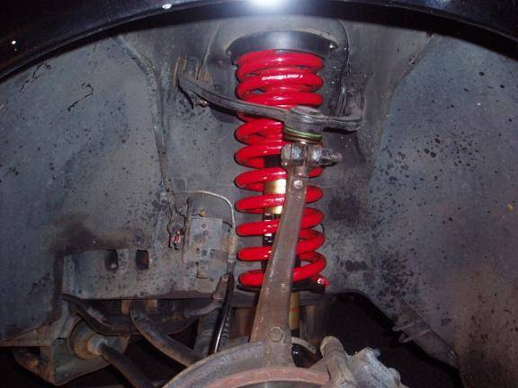

I did the fronts tonight but not the backs. I gotta wake up at 6:30 so I stopped before it got too late. I started at like 6 or so and finished at like 9:30
Jacking up the car slammed took about 45 minutes, and the pass side wasn't too bad, but took me a lil bit because I was trying to get the strut on and it wasn't lineing up the holes were way off.. so I wasted time trying to get it to fit then I thougt they may have to be on certain sides so I tried teh other 1 and it lined up much better( you think they would say, by the way this is for the right side.. but no they didn't) so yea I thought the drivers side would go easier cause I knew what I was doing... WRONG!!! lol upper control arm was seized on and took me about 20 minutes to get off. after that it went easy and I am sorta happy with the results.
When I say sorta I mean because the back is still the air bags and its still running really rough towards teh back. The front feels great

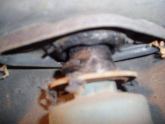

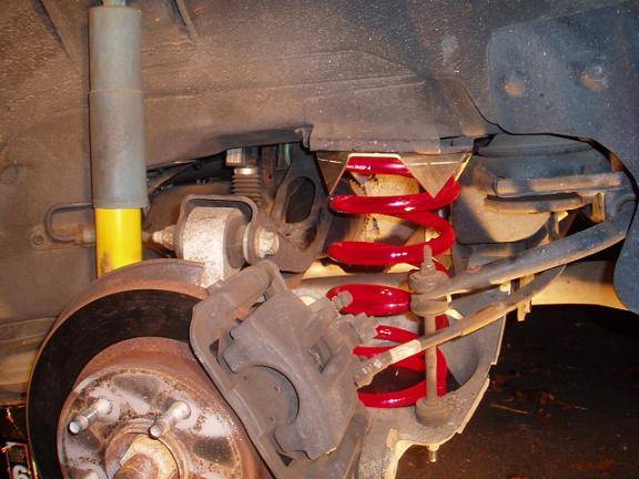

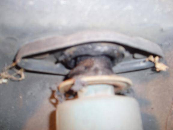

I finished and it rides so much better than no suspension.. it handles alot better than the air ride I think. It is a lil bit rougher riding butthen again my car is not stock, I have cobra shocks in the back. anyway here are some pics... and I also a, gonna post pics of my upper shock mounts/.. do they look warn? I know the pics arn't that clear but I justw anna know.
nice work, how intense was the rear? do you have to unbolt the brake assembly or do you just slip the spring right in?
